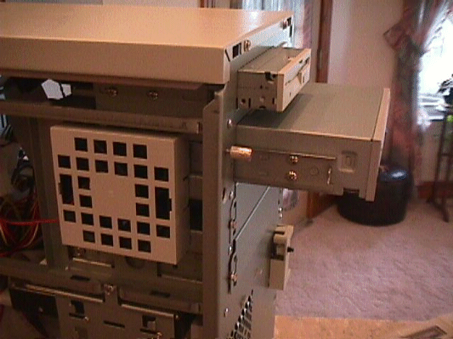

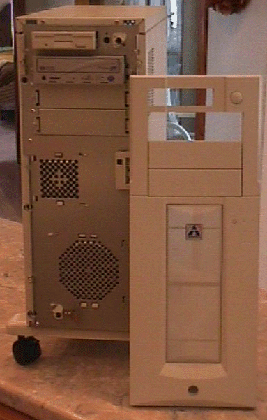

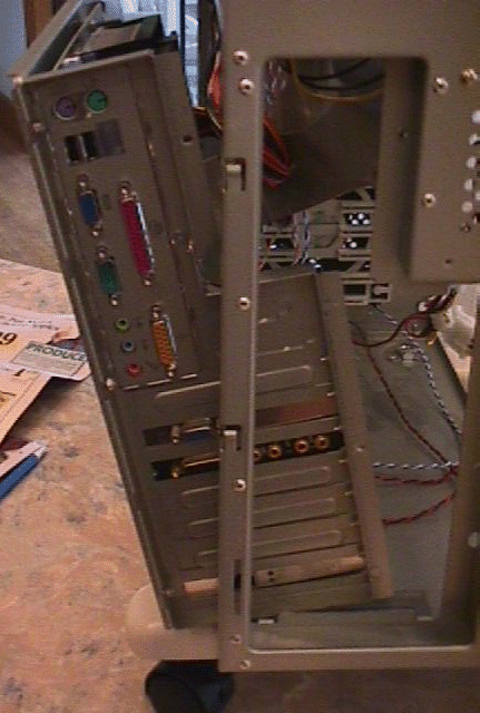

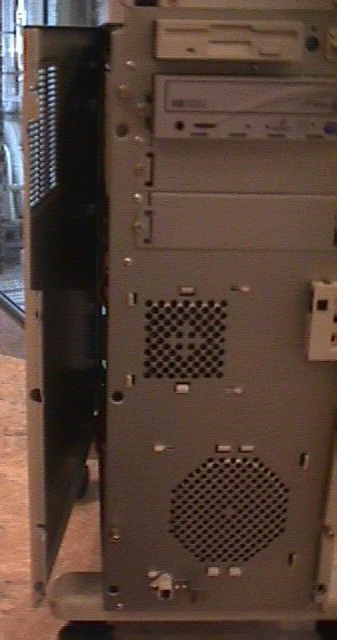

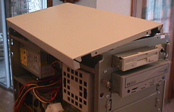

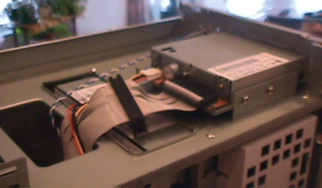

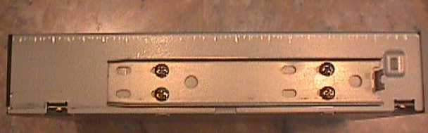

Just to show you how simple the installation is, I decided to include an overview of the steps required along with a few pictures of the installation.
  1. Remove the front cover
  2. Remove the thumb screws holding on the side covers
  3. Remove the 4 screws holding on the motherboard tray
  4. Slide out the motherboard tray and install the motherboard
  5. Slide the motherboard back in and hook up the power
  6. Remove the removable 3.5 drive tray and install the hard drive and replace the removable tray.
  7. Remove the top and install the 3.5 floppy drive.
  8. Screw on the shielded drive bay holder to the CD-Rom drive
  9. Slide in the CD-Rom and install two screws to secure it in place
  10. Install adapter cards
  11. Install the motherboard connectors and power connectors to the devices
  12. Install any optional fans you may have purchased
  13. Close the hinged covers and use the thumbscrews to secure them
  14. Replace the front cover
  15. Power on the system
