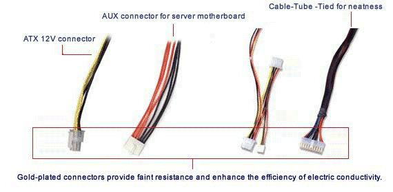

    Cables:
    Model Name
    Output Cables
    ATX + 12V Cable
    AUX Cabel
    Cable Length
    EG365P-VE FCA
    8+2
    yes
    yes
    800mm
    For a picture of the different cables click here
