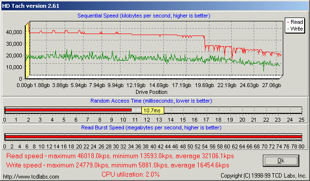

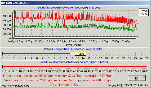

HDTACH
(Promise Raid 0)
(AMI Raid 0)
The results show that the Promise controller outperforms the AMI in both read/write, burst speed. It also shows a noticeable difference in CPU utilization. Winbench will be a good test to verify these scores.
(Promise Raid 1)
(AMI Raid 1)
In comparing RAID 1 results it is clear to see that the Promise greatly outperforms that of the AMI in all areas.

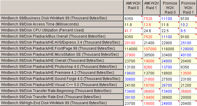

Winbench 99
(IDE Raid Controller Comparison)

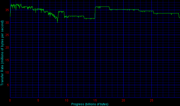

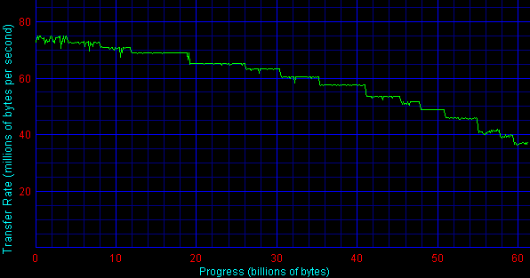

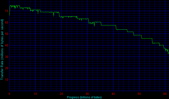

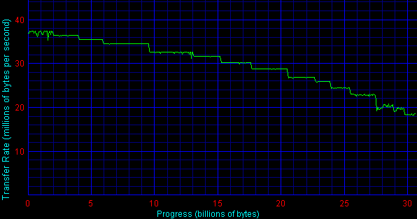

AMI RAID0 STR Graph
Promise RAID0 STR Graph
AMI RAID1 STR Graph
Promise RAID1 STR Graph
Winbench results seem to correlate with that of the previous benchmarks. High-End and Disk Winmarks for the Promise in both RAID0 and RAID1 outperform that of the AMI. CPU Utilization also correlates as it shows that the Promise controller uses quite a bit less CPU utilization that that of the AMI. Overall I think there is no doubt that the Promise beat out the AMI.
In looking at the STR RAID1 results you can see a noticeable difference. While both start out about the same, while the MegaRaid100 slowly drops, the FastTrack100 TX2 seems to maintain its course, while fluctuating a little.
