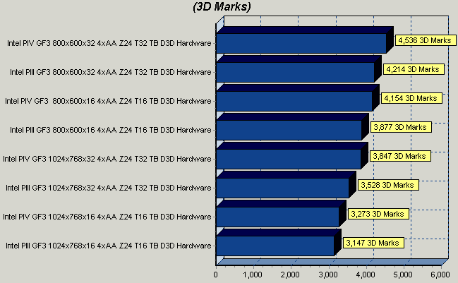

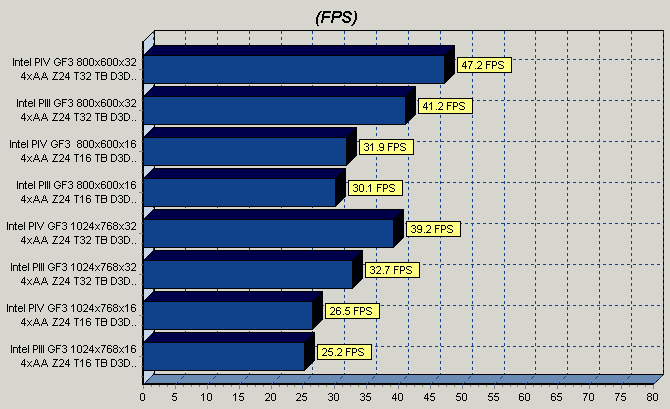

3Dmark 2001 - Provides a 3D Graphics Subsystem test.
From the results you can see a definite increase in 3D Marks, although not very much as I would have expected.
Suprisingly there isn't very much of a increase in FPS between the P3 and P4. From the results you can see about a 1 - 7 fps increase.

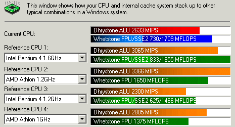

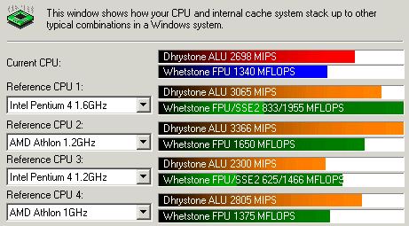

Sisoft Sandra 2001 - Provides a synthetic benchmark for various components of a system.
CPU Bench
P4
P3

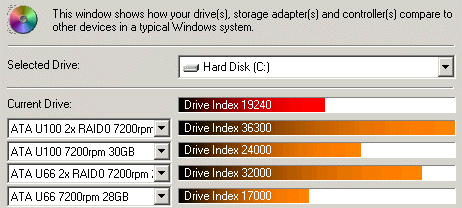

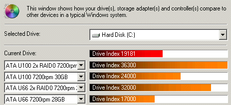

DriveBench
P4
P3
No real difference here, in fact the P3 actually scored higher. Granted this is a synthetic benchmark that fluctuates, there is still no real performance boost seen here.

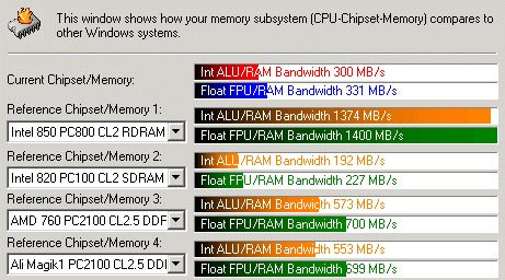

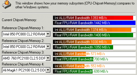

MemBench
P4
P3
There can definitely be seen a difference here between PC133 SDRAM and PC800 RDRAM.

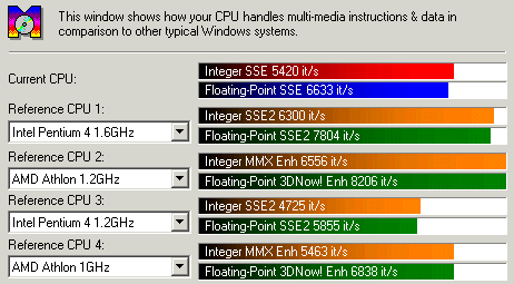

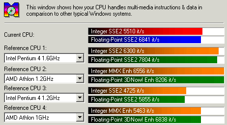

MultiMedia Bench
P4
P3
Slight increase in multimedia instruction handling performance.

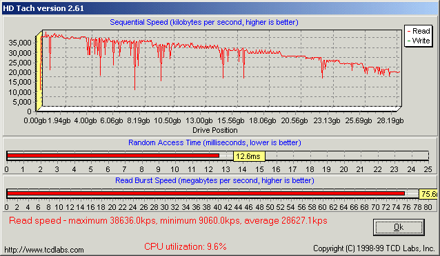

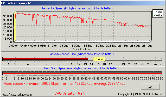

HDTach
P4
P3
Results show a reduction in CPU utilization and faster burst speed-readings with the P4 however random access time seems to be higher.

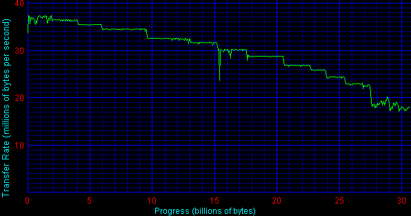

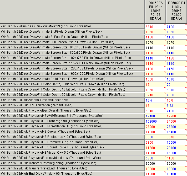

Winbench 99

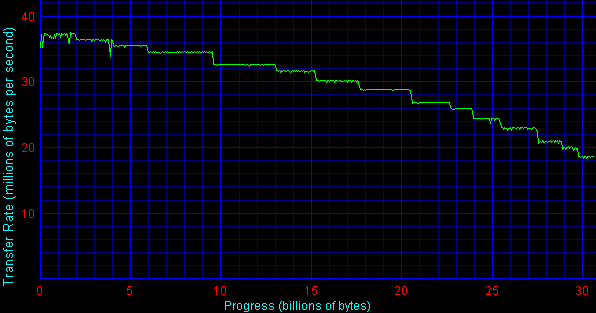

Hard Drive Sustained Transfer Rate Test
P4
P3
Overall a performance boost can be seen here when testing both disk application playbacks, transfer rates, and direct draw graphics testing.
